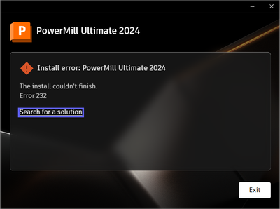

I just tried to install Powermill 2024.
From my Autodesk account, downloaded this: "Create_Installer_PWRMU_2024_English_WIN64.exe"
Which is just a downloader.
After it finished downloading the install package (incidentally it put the files wherever it pleased without asking), I chose the "show in folder option", Then I ran the "setup.exe" file as administrator.
At some point during the installation, it failed and gave me this error:
(same thing happened when trying to install Powershape Ultimate 2024)
Not sure if there was some other software component that has to be installed first?

Hello @glen_h. I'm sorry you're having this problem. Can you please contact Autodesk support for assistance: https://www.autodesk.co.uk/support/contact-support .

glen_h
Big thanks to Goran from Autodesk Support Chat.
As per his instructions, I followed the steps in this article:
"Install Failed - Error 232" when installing AutoCAD LT or Revit LT (autodesk.com)
Then I was able to install Powermill Ultimate 2024 and Powershape Ultimate 2024 without issue.
