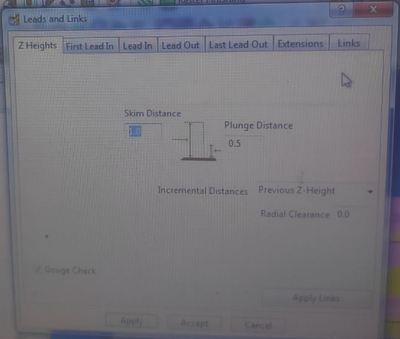

am161363
where is this located in powermill 2022
269 Views
1 Reply
Reply (1)
iamcdn79
Skim distance is now called axial clearance.
Radial clearance is still called radial clearance but moved under axial clearance.
