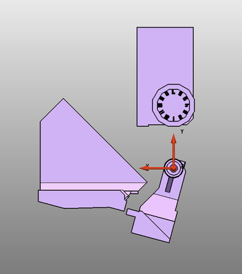

I am trying to build an MTD for this Mazak QT350 MSY for milling only. I understand how to pull vectors for rotaries, but it doesnt seem like the linear axis' can work the same. Below I have the model rotated @30° around the center of the primary spindle center so the Y axis and Z move as expected but the turret carrier needs to traverse @45° and no matter what I place in the IJ vectors it will not accept it. Even if I was trying to get it to move with a single value, I="0.707" moves the same as I="1". Any help would be appreciated, if this is possible at all.

This looked like a potential solution but I failed to mention the other moving parts. The Y axis sits on top of the sliding "X" and the two move simultaneously when machining I've rotated the entire model about the Z to make the Y and Z move orthogonally. There is no intention to use this machine for turning using PowerMill, only milling operations. While the 45° axis may not be a serious need for simulation, the motions related to the physical machine will not match. I've attached the MTD file to this response in the hopes it can be done, even with a cobbled solution.

My original theory was correct, you just needed to work out some of the details to make it work for this configuration. I ended up getting it to work by changing a few things.
First, I Changed the world coordinate system so that the X and Z were perpendicular instead of the Y and Z. This way I could wrap the fake rotary axis around just the Y axis and not both the X & Y. Next I rotated the Y CAD around the world workplane 45 degrees so that it lined up with the world, Y axis.
Then in the mtd, I had the fake rotary axis home position set to -45 degrees so that it rotates into the correct position, and now moves at a 45 degree angle from the X.
Attached is the solution I came up with.

While this moves as expected manually I don't think the ability to simulate with it will work. No matter what I do I get the same error:
I tried adding the appropriate strokes to each axis, I removed them, nothing seems to allow me to simulate. It would appear that the hidden rotary axis isn't allowing the rest of the axis' to move.
