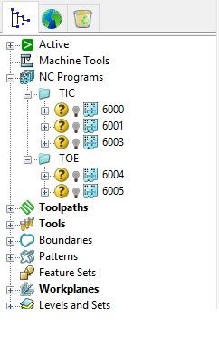

Thank you for you help, but it doesn't match with my expectation. I had a NC program like this:
And when I run my macro above, I will have a file in C drive like
Can I have the macro so that when I run it, I can get toolpath time instead of toolpath length like this: ( the time will be copied at the row where i highlighted at the photo above)
Please help me if you have any solution. Thank you very much !
