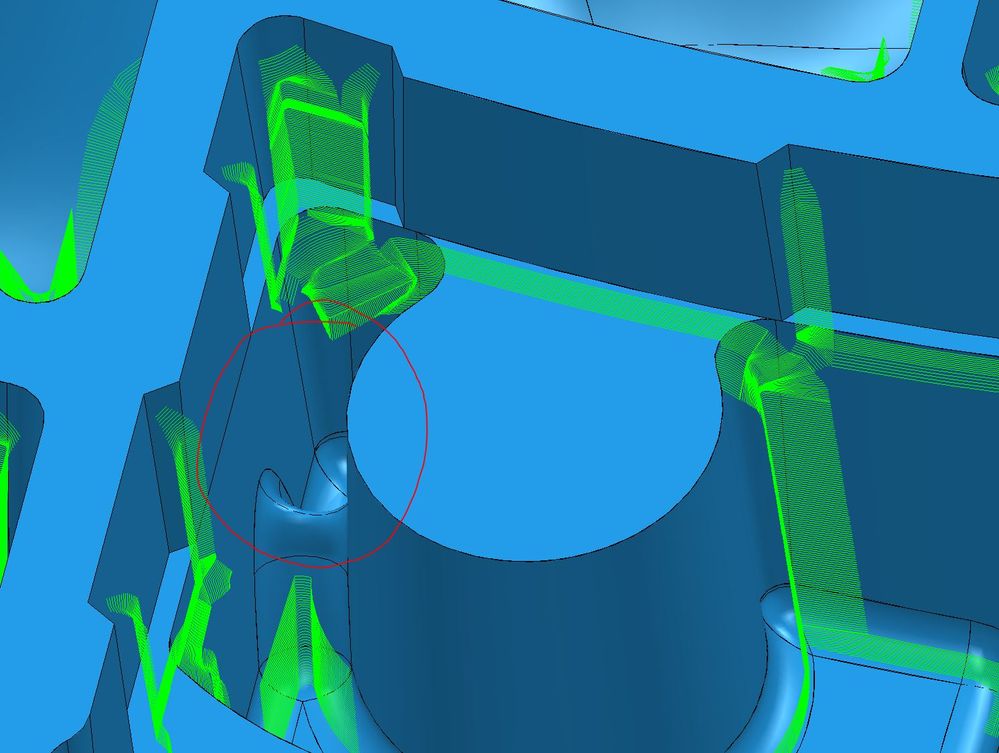

Would anyone here want to give advice or share a PowerMill project they use for machining graphite electrodes?  We are having trouble with sharp inside corners.  We tend to get small gouges.  We make thousands of these a year with every one of them different.  I have a macro that I've set up to calculate them automatically, and then afterwards we open it up to review and tweak them as needed.
I do not currently use one of the corner finishing strategies because it doesn't seem reliable.  For example, I have a 1/16 ball that is rest finishing what the previous tool (1/8 ball) cannot get.  My toolpath looks like so.  Note the circled area.
If I try an automatic corner finishing toolpath, I get this.  Leads and links turned off for clarity.Automatic Corner Finishing.jpg
Note how it doesn't attempt to get that area at all.
Is it better to use a combination of toolpaths to get the corners?  I don't really think the corner finishing would improve the gouging much anyway.  I have thought about using a constant Z inside the boundary and using the high speed option, but then how do you reference that for the next smaller tool?
Any help would be appreciated.

Normally what I would use on graphite is to use optimized constant z over the entire model using the smallest tool needed (Diamond coated) that would finish all the smaller corners. That stratagey works 90% of the time for me.
Another stratagey that I would use if optimized constant z doesn't work is steep/shallow over the entire model with the smallest cutter. The only problem with steep/shallow is the 3d offset portion for shallow areas starts from the inside out. Would need to select those areas manually  with a macro provided from @5axes found here if you want to start from the outside and work your way in
Finishing the entire model with the smallest tools eliminates blending issues and corner picking.
The only downfall with that is it can take alot of machining time if its a large model, and hopefully you don't need long tools for deep models

The first screenshot in my initial post is a steep/shallow toolpath, which is what I currently use.  Optimized Z gives similar results.  Ideally there would be a high speed arc fit corners option within one of those toolpaths, but I think that has been on the wishlist for many years already.  I'm guessing it must not be an easy thing to do.

I looked at your project and can't see what the issue would be in your provided snapshot. The toolpath looks good to me. Is your issue with it that you can't add arcs to the corners?
I've noticed that you have your links set to incremental, is there a reason you're using that and not skim?
I would also suggest adding circular arcs to your first skim choice instead of skim to keep the tool down see attached pic of before and after

I will look into the leads/links things you suggest.  The real issue is that the vertical corners tend to have small gouges in the transitions from one tool size to the next.  If some sort of arc-fitting were possible in the corners, I think that would eliminate the problem.  Since it really isn't other than constant Z (which would open up other problems) I am hoping to find a better way to program the corners to avoid that somehow.  The screenshots were an example of what I currently use, how I tried to use one of the corner finishing strategies as someone at Autodesk had suggested to me, and why that fails in my opinion.

I have been machining electrodes for 20 years using powermill.I generally use corner finishing.
When i run into problems with bad toolpath such as yours.I first create a rest boundary.Than i run a constant z
toolpath with arc fit on so i swing a radius in the corner.Than i create a shallow boundary inside the rest boundary.
I trim out the constant z toolpath to the shallow boundry to get rid of any large stepovers.Than a 3d offset toolpath with the shallow boundary.A pain in the ass doing this, but it creates good toolpath with an excellent finish.Adjust your leads and links to what the one guy said.

I have never had an issue with this.I usually swing a .002 arc fit radius in the corner with constant z.The constant z toolpath takes out most of the material.Then i go outside in on my 3d toolpath.I generally finish my electrode with a 4mm ball cutter.Than corner finish with a 3 mm to a 2mm to 1mm.The smallest cutter i go down to is .4mm.
