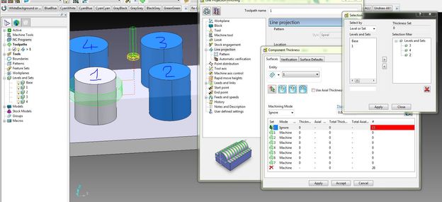

I have 4 workpieces arranged in a tensioning device with a grid 50 x 50. Each of them has a diameter of about 30mm. I have to calculate them with line projection and a lollipop-like tool because they have some undercut.
Now my problem is: i want to calculate the first workpiece and the others disturb this, although they are really far enough away. The "preview" shows the white lines, which are projected from outside. Now my toolpath on the workpiece to be processed, is interrupted in these areas, where the white lines touch the other workpieces. Ok, I can set the others to ignore, but with this the collision test is senseless...
Is there any possibility to reduce the enlargement of these projection lines? Incidentally, they grow up and get smaller with the blank and the tool diameter.
(PowerMILL 2015)

The result looks like this:
Message 3 of 21
DanMcDan
Does not constant Z with undercutting work for this?
If not you could set it to "ignore" all the other surfaces in the Thickness tab.

What's wrong with the ignore option of the other cylindrical features? You said they are far away from each other anyway so there would be plenty of space between them to put the tool in there.
I made quickly something similar and line projection is working fine on that if you ignore the other cylindrical features.
I have placed them in different levels so I can select them easily.
Kind regards
George

I have had this problem many times. Ignore works but is a bad option, too easy to ram your leads and links into areas on the model. I always change the block size to only one area, then transform as many as you want, update leads and links last. but you must change block to only one.

I can tell you how to make this work,  get ready to gasp........  Take all the other bosses, I mean the model, select them, MOVE them down, say 20 inches out of the way, calculate, move them back up and translate..

This takes only affect on the surface projection. So anyway. The best and simliest idea is to move the currently unused bosses away while processing a model and replace them all when all the toolpaths are calculated. I've tested it: the gauge and the collision check are successful on every toolpath, which PowerMILL did not calculate completely before. I would this call a bug in the software. Maybe PowerMILL above 2015 doesn not have this fault, I don't know...
Seems as I have to accept your suggestion as solution (at the moment, perhaps the developers read sometimes here in the forum, too)
