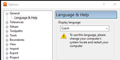

Is there really no other way to change the language of PowerMill than changing the system local language in the latest versions???
The help says: "To use the selected language, change the computer's system local and restart the computer."
What a drawback!!! I know no other CAD/CAM Software with such a restricition..

You can change the Powermill language in the settings. After changing, close and reopen Powermill.

But this does not work - when Windows is English.

Folder is there, but is shows this:
But I dont want to change the computers language!
