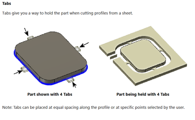

Hello, I want to use Powermill in woodworking as well. I want to throw TABS lines to keep the processed part stable. How can I do this in the Powermill program?

You can do that by creating a boundary first then creating a plane from that boundary. See this video
