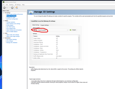

Just wondering if anyone has seen this when backspaceing in an text area.(description on a tool)
im Leaning towards a Graphic card setting because im running on a virtual desktop and have no issues but all our programmers have physical systems. nothing is really poping out at me that looks different then my settings.
200 Views
iamcdn79
Are you using an Nividia graphics card with the global preset set to 3D App - Visual Simulation?
Intel Core i9 13900KF CPU
128 GB Kingston Beast DDR4 SDRAM
PNY RTX A2000 6GB Video Card
WD 1 TB SSD Hard Drive
Windows 11 Pro
dsmits
Its Nvidia RTX 2000 Ada Generation
had it at Base Profile and i did try switching it to 3D App - Visual Simulation
even tried messing with a few settings in
"C:\Program Files\Autodesk\PowerMill 2025\sys\misc\graphics.con" but no luck
just really odd it only does it in the Tool Description page
works fine in all other text areas like Toolpath notes and descriptions.
