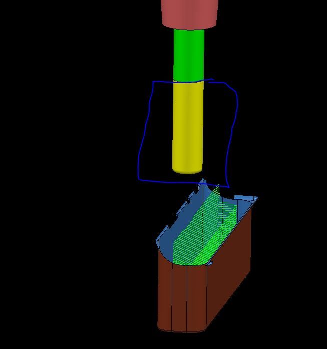

2º
2.JPGin the milling of a cashier both roughing and finishing, if you exceed the size of the tool edge, powermill does not understand that this recessed and gives you collision
this image shows the same tool as the previous one but saying that all of it is cut, I have removed the destalone that carries the tool and so it does not fail ... it is a mistake that we have been dragging for years
and not to mention the bits, they always collide if they do not have all the edge in the whole length of the bit

Have you noticed that in the levels, when you turn off and turn on the bulbs, the level is stuck to the mouse and you are always raising and lowering it to reorder it?
Benjamin.Br
Yes, we are aware of that problem. It is also on our list to fix but is also considered to be fairly low priority.
