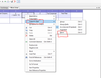

Without seeing your post it's hard to say but you may have a parameter called "Machine X" or "WP Machine X" somewhere in your post and it may be getting the values from that.
The way to turn it off would be to set output to tape to never.

The image at the bottom is only a preview and it doesn't take into consideration the other options you could have active.
Output NC Code, ensure you have TCPC active in the output and confirm the tool tip coordinates inside Powermill using Tool Position and the active output workplane.
