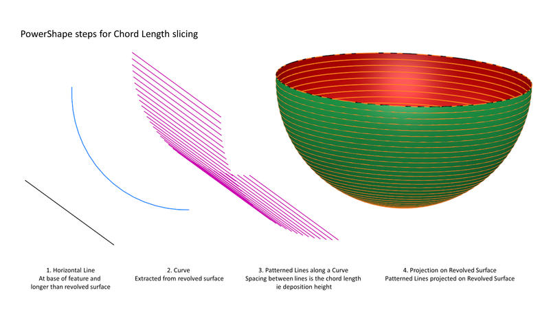

I am trying to create additive toolpaths where the distance between the paths is constant, not in the z-direction, but tangentially along the surface of the part that I am creating. I am using the "Feature Construction" tool, which deals exclusively in distances along the z-axis. Unfortunately, the only way I can currently conceptualize getting the spacing that I want is by manually setting each of the layer heights, and I would rather not do that as it precludes me from creating a generalized macro for creating these additive toolpaths for a variety of shapes. Does anyone have suggestions for creating Profile additive paths with constant distances between layers in 3D, rather than just along the z-axis? Is there maybe a subtractive toolpath that I can use, then convert to additive?
The image below is an example part, a dome. The layers near the top of the part should get closer together as their xy-offset increases, but they remain constantly offset in the z-direction.

There are two options for creating this type of toolpath. I call the toolpath Chord Length Slicing toolpath:
A - Use Surface Finishing Toolpath
In PowerMill
- select surface
- set surface units to distance
- step over in this case is the layer thickness
- set tool axis to Lead/Lean and a 90deg lean angle
B - CAD patterns to CAM toolpaths
- Use PowerShape to create patterns that will be used for toolpath creation later in PowerMill
- copy patterns to PowerMill and embed them on the revolved surface. Embedding ensure that surface normal information are given to the patterns.
- use Embedded Toolplath (no gouge checking)
- set tool axis to Lead/Lean and a -90deg lean angle
