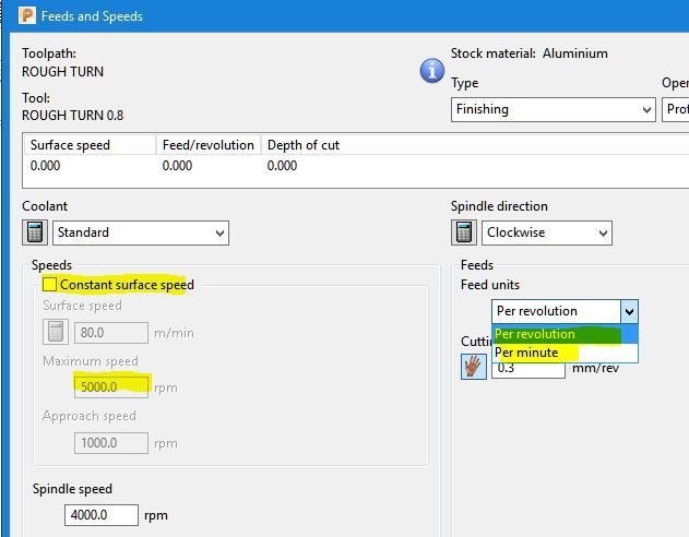

The PP get Spindle Clamping Speed from first toolpath Maximum Speed, if Constant Surface Speed is active else set 3000 rpm.
For proper PP operation please set turning Feed Units Per revolution, milling Feed Units set Per minute. (pic 1.)

Message 18 of 26
in reply to: Anonymous
Thank you for your help Vékási Tibor it works great.
