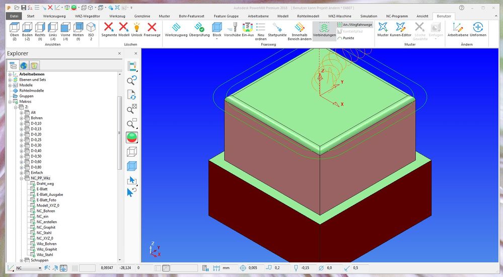

That's my current custom setup but I keep adding as I go along.
