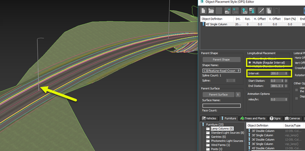

This is the alignment we are going to use to place objects along the road. The first thing we will add will be some street lights.
At the bottom of the dialog box, click the tab for Furniture. I’m using from the Lamp Columns, the 45’ Single Column.
There are several options for placement. First, toggle the radio button for Multiple (Regular Interval) under the Longitudinal Placement section. Second, set an interval. I’m using 200’. Go ahead and click Apply to see how they come in.
In my case, I do not need to assign a rotation, just a horizontal offset.  Play around with your horizontal offset to get it exactly where you want it…
Now we are going to Copy and Paste the Object Definition for the opposite side of the road. When you do that, you need to apply a negative (-) value in the offset field and a rotation of 180…Copy.png Paste.pngClick Apply to see your results. If you are satisfied with the results, then click OK. Do not save the current style when prompted.

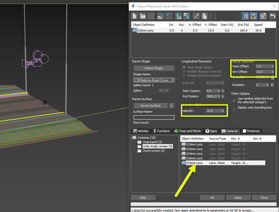

Now for the last and final piece of the puzzle. We are going to create a camera path to move along the road.
Go to Civil View > Civil View > Object Placement Style Editor. Click the Add New Element button. Add New Element Button.png
Click the Parent Shape button and select the centerline of the road. At the bottom of the dialog box, click the Cameras tab. Select the desired camera you want to use. I’m using the Wide Angle Lens, 035mm Lens. Position the camera to your liking. As for the miles per hour, make it slower or faster than you made the cars. The reason for this is that you don’t want to lock on to a car.
Once you have it set, click OK and do not save the style.
