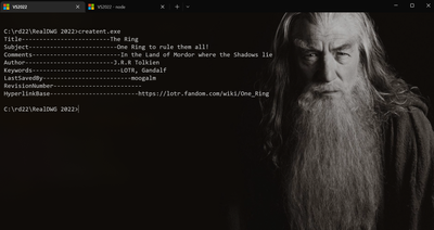

  Some more beautification -
template<typename ...Args>
void log(Args && ...args)
	(std::wcout << ... << args);
#define GET_SUMMINFO_STRING(PROPERTY_NAME,strProp) {                                                                    \
      AcDbDatabaseSummaryInfo* pSummaryInfo = nullptr;                                                                   \
    if (!eOkVerify(acdbGetSummaryInfo(acdbHostApplicationServices()->workingDatabase(), pSummaryInfo)))                   \
         return -1;                                                                                                        \
    ACHAR* pPropertyString = nullptr;                                                                                       \
    if (!eOkVerify(pSummaryInfo->get##PROPERTY_NAME(pPropertyString)))                                                       \
         return -1;                                                                                                           \
    if (pPropertyString != nullptr) {                                                                                          \
        strProp = pPropertyString;                                                                                              \
        log(#PROPERTY_NAME,L"-------------------------", strProp, L"\n");                                                        \
        delete pPropertyString;                                                                                                   \
int _tmain(int argc, TCHAR* argv[])
    acdbSetHostApplicationServices(&gCreatentHostApp);
    acdbValidateSetup(AcLocale(L"en", L"us"));
    AcDbDatabase db(Adesk::kFalse);
    db.readDwgFile(L"D:\\Temp\\oneRing.dwg");
    acdbHostApplicationServices()->setWorkingDatabase(&db);
    std::wstring strProp;
    GET_SUMMINFO_STRING(Title, strProp);
    GET_SUMMINFO_STRING(Subject, strProp);
    GET_SUMMINFO_STRING(Comments, strProp);
    GET_SUMMINFO_STRING(Author, strProp);
    GET_SUMMINFO_STRING(Keywords, strProp);
    GET_SUMMINFO_STRING(LastSavedBy, strProp);
    GET_SUMMINFO_STRING(RevisionNumber, strProp);
	GET_SUMMINFO_STRING(HyperlinkBase, strProp);
    acdbCleanUp();
    return 0;
Message 4 of 8

muaslam
Indeed I missed setting Host Application Services. And once, I set Host Application Services like done by moogalm, it works fine for me. I have accepted his answer as a solution.
