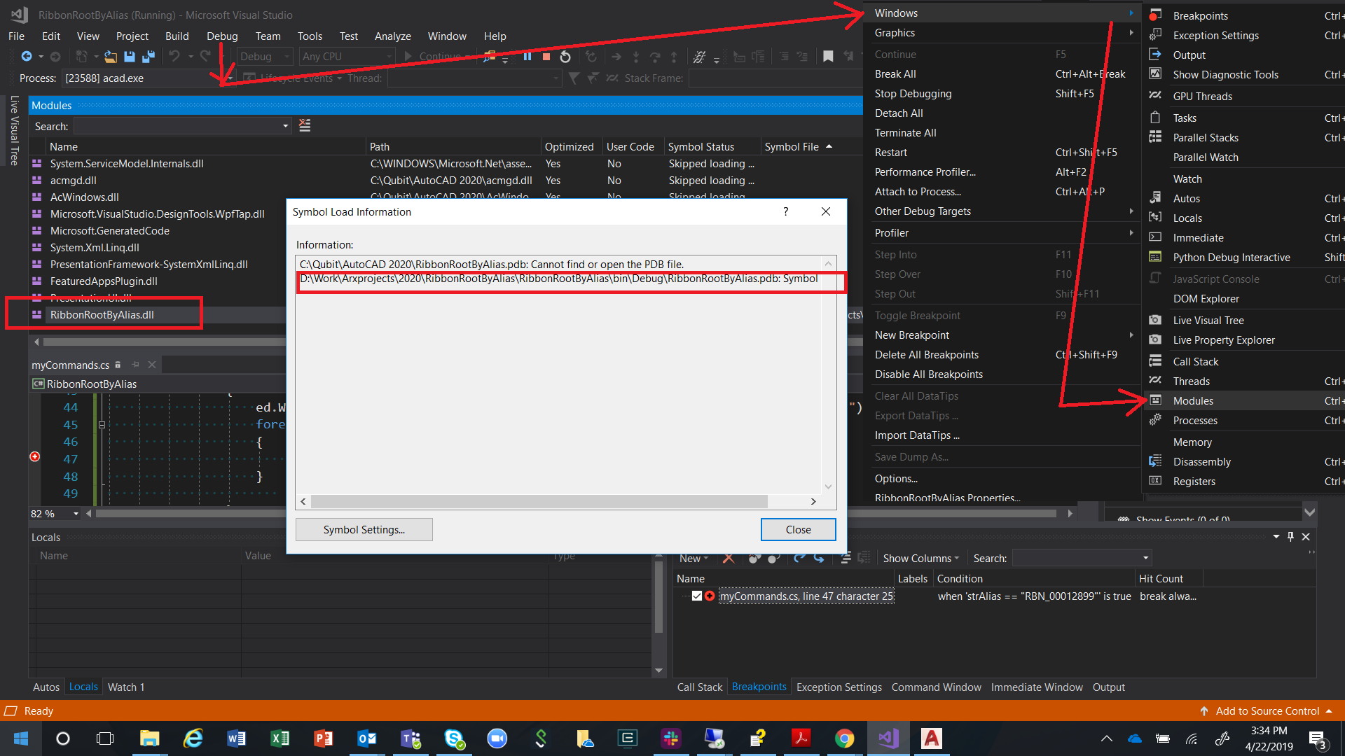

If you are not able hitting breakpoint for .NET module, either the application is not able to finding the associated PDB or it is located in wrong direction.
After starting the debugger either press CTRL+ALT+U
Or, go to Debug\Windows\Modules
Find your .NET module from the list, right click for Symbol Load Information
Screenshot is attached

TEK1
Thank you
it was a silly question. Break point does come live once netloaded
