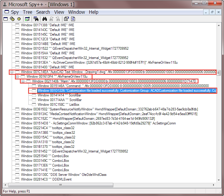

Expert Elite Member
Alexander.Rivilis
I've found undocumented function:
HWND AcadGetTextFrameHandle(void);
Maybe it help you. Sample code:
static void MyGroupTextFrame () {
  HWND hwnd = AcadGetTextFrameHandle();
  WCHAR buf[100000]=L"";
  WCHAR TotalBuf[100000]=L"";
  if (hwnd) {
    if (GetWindowTextW(hwnd, buf, sizeof(buf)/sizeof(buf[0])-1) > 0) {
      StrCatW(TotalBuf,buf);
    HWND hwndChild = GetWindow(hwnd,GW_CHILD);
    hwndChild = GetWindow(hwndChild,GW_CHILD);
    do {
      if (GetWindowTextW(hwndChild, buf, sizeof(buf)/sizeof(buf[0])-1) > 0) {
        StrCatW(TotalBuf,_T("\n")); StrCatW(TotalBuf,buf);
    } while (hwndChild = GetWindow(hwndChild, GW_HWNDNEXT));
    acutPrintf(_T("\nBuf==%s"), TotalBuf);

Dear Alexander.Rivilis:
Thanks for your replay, it solves my problem.
