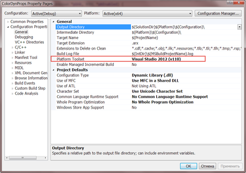

I just noticed that wizard created a project that is somewhat strange. In properties there was "platform toolset" set to v100 and in "c/c++ general" there were additional #using directories set to c:\Program Files\AutoCAD 2011\;%(AdditionalUsingDirectories) which is completely wrong.
I have set Autocad 2016 directory properly during installation of wizard. And platform should be V110 (right?)
Message 8 of 10
Alexander.Rivilis
@Anonymous wrote:
one more info:

So, in the end it all worked well. Thank you for assistance. I would like to point out two things:
1. In my humble opinion, this topic of proper installation and settings of Object ARX, ARX Wizard and Visual Studio deserves a sticky thread at the beginning, because there are many questions in the forum regarding this.
2. Problematic ARX Wizard 2016 was downloaded from Autodesk official site (developer part, at the bottom of the page under "tools" section). It is attached. This Wizard makes project so that when I use x64 platform, both Release and Debug, there is mentioned problem of wrong platform v100 and old Autocad path. I have created new project with Extension DLL using MFC shared DLL and checked Autocad support.
