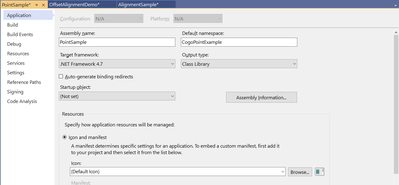

Could you capture your Project properties\ application and Project properties\ debug?
I have 2 assumptions:
1. Maybe something wrong with your project's Target framework, be sure to set project Target framework to .Net framework 4.7 (not 4.7.1 nor 4.7.2)
2. Maybe something wrong with your Debug\ Start external program, it should be (if autocad installed to default folder):
"C:\Program Files\Autodesk\AutoCAD 2020\acad.exe"
Message 5 of 16

@jmcfarland1996
From my poor experiences, I'm afraid that you've started with wrong project type.
For VS 2019, I started from the type "WPF app (.Net framework)",  and Project properties\ application\ Application type (Output type) should be: "WPF class library" not "Class library"
Here is my project properties, it works with CV3D 2022. The project can show user form over CV3D,

Update 7/2: After creating a test C# project with "Autocad 2022 Dotnet Wizard", I find out that the C# project type created by the wizard is non-WPF.
(This is different from the VB project type created by the wizard (WPF))
With C# project created by the Wizard, I can start Autocad 2022 from VS debug after turn off Loader Lock.
I also attach the solution with C# project created by the wizard.
I've checked the sample solution at:
C:\Program Files\Autodesk\AutoCAD 2022\C3D\Sample\Civil 3D API\DotNet
If the Output type is "Class Library" then Debug\ Start external program is unchecked.
In this case I can still debug by:
1. In the same solution of your existing project, add another WPF project, declare Application & Debug tab, declare references as your existing project (I'm not sure if it is necessary), set the WPF as your startup project.
2. From VS 2019, start debug (F5) to open Acad.exe, in that Acad.exe instance, netload the existing non-WPF project .dll file which is located in \bin\Debug folder.
By the way, the previous WPF project I showed you was a mimic of another created by Autocad 2018 VB plug-in for VB.net in VS 2015.  Don't understand why it must be WPF, but it is working.
