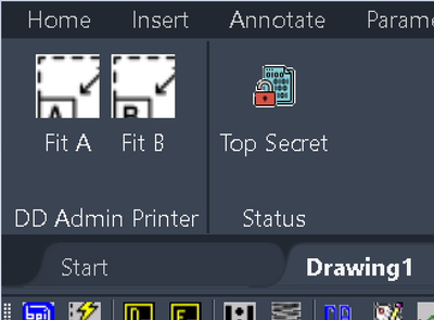

I created a print tab on the ribbon in Inventor (See top screenshot). I am try to create the same thing in AutoCAD (See second screenshot). Notice how the image is smaller in the autocad button than the inventor button. Is there a way to make autocad's image bigger?
RibbonButton.Size is for large or collapsed buttons
RibbonButton.Width doesn't seem to make the button wider
If I set the image size to 64,64 the image stays the same size but the graphic gets bigger (See bottom screenshot).
I know it looks bigger, but I zoomed in to show the graphic better.\/
