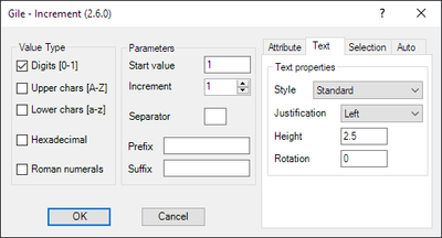

I do not have such problem with my dialogs , neither with WinForm nor with WPF.
WinForm:
WPF:
How do you show your dialogs ?
You should use Application.ShowModalDialog (WinForm) or Application.ShowModalWindow (WPF).

I am using Form.ShowDialog(), I did tried your application.showmodeldialog(frm) but without enablevisualstyle it looks pixelated too. 😞 may be something wrong with my autocad settings?

From the developper's documentation:
"Custom dialog boxes or forms in the AutoCAD Managed .NET API extend the classes from the System.Windows.Forms namespace directly. However, such applications should not call the Form.ShowDialog method but instead use the Autodesk.AutoCAD.ApplicationServices.Application.ShowModalDialog and ShowModelessDialog methods to display their custom forms. Using Form.ShowDialog in an AutoCAD extension application may result in unexpected behavior."

Okay, i'll use Application.ShowModalDialog().
