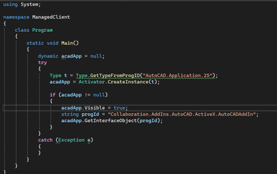

Hello @aknigin,
I have the exact same issue, AcadAppObject.GetInterfaceObject("ProgID_OF_ADDIN_LOADED_IN_ACAD") is causing exception with .NET Core dll. The same code was working with .NET 4.8 with regasm.
Could you figure out a solution to the issue?
This is what I have tried so far :
1) Create the .NET Core 8.0 dll sample
2) regsrv the dll
3) Start ACAD.exe and NETLOAD the custom dll
3) From a seperate console APP, try to get the interface
Message 9 of 13

@aknigin
Thank you for your valuable comment on the topic. It provided helpful direction for further investigation, and I finally managed to resolve the issue after struggling for over a month.
Below is my understanding of the problem, which I hope will help others facing a similar challenge:
What worked for me was using the GUID of IID_IDispatch as the GUID for the implemented interface. From what I’ve learned, in .NET Framework (up to version 4.8), COM interfaces should not derive directly from IDispatch. Instead, they should use the [InterfaceType(ComInterfaceType.InterfaceIsIDispatch)] attribute to ensure proper usage. Directly inheriting from IDispatch is not considered valid in this context.
However, in .NET Core, this direct inheritance doesn’t seem to work (though I’m not entirely sure why). To resolve the issue, I used the IID of IDispatch directly as the GUID of the implemented interface, and that worked successfully.
Message 11 of 13
