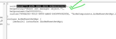

  • You can retrieve class id, by using " oleview <.tlb>" from Visual Studio Developer command.
  • From the oleview editor, get the “UUID of required component”
  • Search the class id in registry hive.
  • If it is not present, go and register the typelib.

Anyway, I did find the UUID you show for 2018 in the registry.
