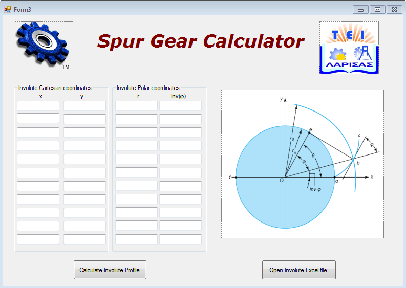

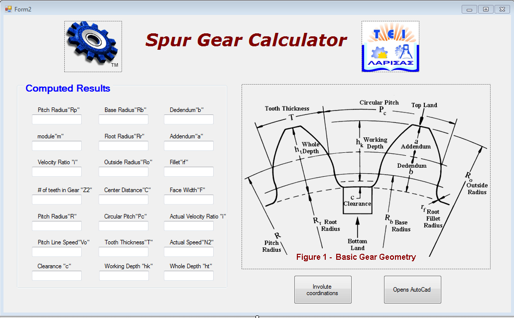

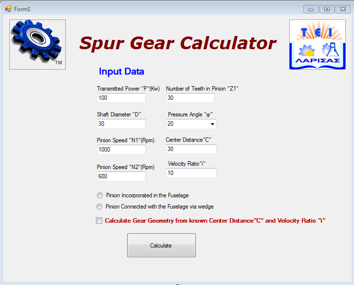

hello,i am new in programming and in my first succesfull attempt i developed a windows form based stand alone application in Vb.net 2010 that calculates all the geometry data needed for a Spur Gear ,my final goal is to send all Calculated data needed in Autocad 2012 and draw automatticly the Spur Gear.
At first i started to experiment my self with a simple only task (created a new project only for this) to draw 4 circles with the same center (radius1,2,3,4) in autocad with a simple click of the command button.
The code i used is the following (for 1circle) but it returned a error  like this>>         SendACommandToAutoCAD()-->>Could not load file or assembly 'Acmgd, Version=18.2.0.0, Culture=neutral, PublicKeyToken=null' or one of its dependencies. The system cannot find the file specified.
