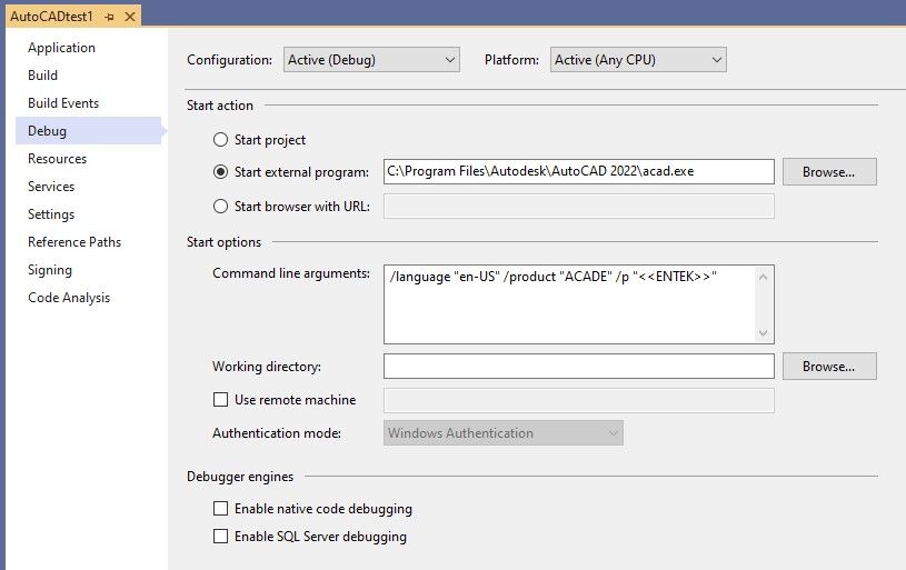

Just recently switch from AutoCAD Electrical 2018 to 2022 and our IT group finally gave me Visual Studios again, running VS 2019.
I have everything basically working, however when I debug Visual Studio is starting AutoCAD Vanilla. In the past when I had Visual Studio the debug would launch AutoCAD Electrical. Something seems to have changed and I cant find the answer.
How do I make the debug launch AutoCAD Electrical 2022 from Visual Studio 2019?

fieldguy

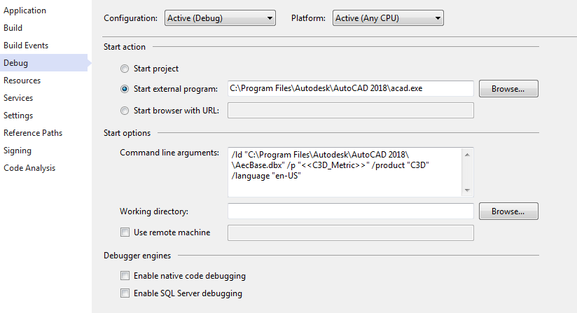

your debug settings in vs should look something like this.  you can get the required info from the "Target" in your desktop icon.

Hello I use2021-11-18 16_42_22-ITEC_Plugin_commun - Microsoft Visual Studio (Administrateur).png

Alfred.NESWADBA
I guess you need to add
/product "ACADE"
to the commandline parameters.

klonbeck
Thank @fieldguy@didier_lourdelle  & @Alfred.NESWADBA for the input.
I was thinking the Command line arguments in Visual Studio would be the answer, but I was able to find any clear examples.
Added the language, product and the profile information. AutoCAD Electrical is now launching when I debug.
