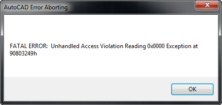

I want to filter information (Name/Age/..) from textbox and show results in a listview (WPF) as an example from https://wpf-tutorial.com/listview-control/listview-filtering/ . However, There was an error and my program stopped. When I debugged this program, it stopped at the code line:
InitializeComponent();
 Please advise me,

I mean that I want to create a dialog WPF with a Filter function via AutoCAD command method.
       [CommandMethod("SEARCHTEST")]
        public void cmd_SearchTest()
            var SearchDialog = new Search();
            var result = AcAp.ShowModalWindow(SearchDialog);
Code-behind:
using System.Windows;
using System.Windows.Controls;
using System.Windows.Data;
using System.Windows.Input;
namespace Test
    public partial class Search : Window
        public Search()
            List<User> items = new List<User>();
            items.Add(new User() { Name = "John Doe", Age = 42 });
            items.Add(new User() { Name = "Jane Doe", Age = 39 });
            lvSearch.ItemsSource = items;
            CollectionView view = (CollectionView)CollectionViewSource.GetDefaultView(lvSearch.ItemsSource);
            view.Filter = User_Filter;
        private void TxtSearch_TextChanged(object sender,TextChangedEventArgs e)
            CollectionViewSource.GetDefaultView(lvSearch.ItemsSource).Refresh();
        private bool User_Filter(object item)
            if (string.IsNullOrEmpty(txtSearch.Text))
                return true;
            else
                return (item as User).Name.IndexOf(txtSearch.Text, StringComparison.OrdinalIgnoreCase)>=0;
        public class User
            public string Name { get; set; }
            public int Age { get; set; }
When I run this command, an error message appears as bellow photo

It works for me like this:
XAML
<Window x:Class="Test.Search"
        xmlns="http://schemas.microsoft.com/winfx/2006/xaml/presentation"
        xmlns:x="http://schemas.microsoft.com/winfx/2006/xaml"
        xmlns:d="http://schemas.microsoft.com/expression/blend/2008"
        xmlns:mc="http://schemas.openxmlformats.org/markup-compatibility/2006"
        mc:Ignorable="d"
        Title="FilteringSample" Height="200" Width="300">
    <DockPanel Margin="10">
        <TextBox DockPanel.Dock="Top" Margin="0,0,0,10" Name="txtSearch" TextChanged="TxtSearch_TextChanged" />
        <ListView Name="lvSearch">
            <ListView.View>
                <GridView>
                    <GridViewColumn Header="Name" Width="120" DisplayMemberBinding="{Binding Name}" />
                    <GridViewColumn Header="Age" Width="50" DisplayMemberBinding="{Binding Age}" />
                </GridView>
            </ListView.View>
        </ListView>
    </DockPanel>
</Window>
Code behind:
using System;
using System.Collections.Generic;
namespace Test
        public Search()
        private void TxtSearch_TextChanged(object sender, TextChangedEventArgs e)
                return true;
            else
                return (item as User).Name.IndexOf(txtSearch.Text, StringComparison.OrdinalIgnoreCase) >= 0;
        public class User
Commands class:
using Autodesk.AutoCAD.Runtime;
using AcAp = Autodesk.AutoCAD.ApplicationServices.Application;
namespace Test
    public class Commands

Thanks for your test, _gile !
Maybe some causes from my system, I'm trying to find them.
