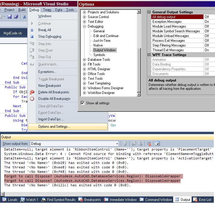

Just one more question and I am done. I work with Visual studio and and don't know how to activate appropriate debug message to tell me I have to dispose. I attach the setting I have as image. Let me know please if with this setting I should see that warning you mentioned.

The settings I was referring to are in a different location, in the options dialog (which you can to as shown below, from the debug pulldown, or also from the Tools pulldown ->Options) Then you have to make sure Show All Settings is checked in the bottom left.  Go to Debugging->Output Window.  image shows how mine were set.
Since I didn't see an option in there that jumped out at me for the dispose messages, I fiddled around a bit, and turned all of them off.  Then I tested again, and I still got my "Forgot to call dispose?" message that you see in the image.  Obviously I have a missing dispose call somewhere that I need to find 😉  But more importantly, you might not need to mess with these options because like I said, even with all of them off I still got my message.

I just noticed that if you right-click in the output window, you get direct access to toggle the "General Output Settings" plus one more called "Program Output".  If you turn off Program output, pretty much everything goes away, including the Dispose messages.
