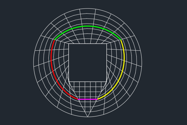

@_gile I try your sample. It works perfectly. Result is 4 piece of splines that are on the intersection plane an the surface. My thanks are less than your helps.
Message 9 of 13
ekoneo
Hi @_gile,
Depending on loft surface shape, the result intersection objects can be more than 1 objects as spline, polyline, circle etc.
I try to join if there are more than 1 pieces.
Green, Red, Yellow and Magenta colored splinesGreen, Red, Yellow and Magenta colored splines
