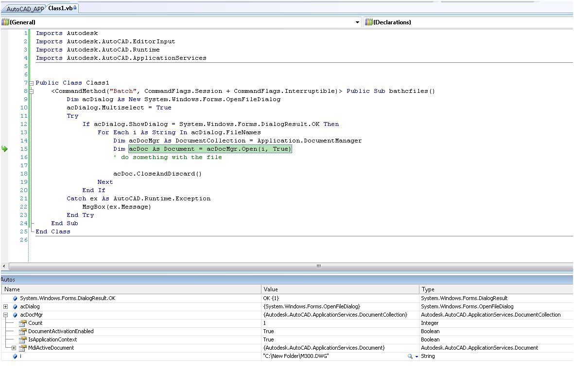

I am a bit lost, tried all sorts of commandflags and still nothing. Tried the resave options and it craps out at "db.ReadDwgFile(FileName, FileOpenMode.OpenForReadAndReadShare, True, "")"
the error is "eNoInputFiler"
I have attached a sample drawing with this, this drawing has had all the proprietary information removed and resaved as an AutoCAD Mechanical 2008 file.
this is a screenshot of my debug window.
Acad App

Mike.Wohletz

Message 11 of 11
Mike.Wohletz
Thanks that solved the problem, my first issue was not being able to open the files in a batch and the DWGCHECK set to 2 solved that. This will allow me to batch plot or some other routine that will not make changes to the file. the second is the DwgFileWasSavedByAutodeskSoftware will solve the problem of modifying drawing, if I hit this and it is false I know that it was not done in AutoCAD and can move on to the next.
