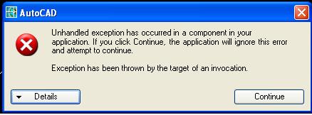

giskumar
HI,
This is the error i am getting for the following code
2394iF772DDE005DE5F63

Message 6 of 9
You had to press button Details in this message window in order to locate line of code throwing exception.

giskumar
HI,
These are the error details
System.Reflection.TargetInvocationException: Exception has been thrown by the target of an invocation. ---> Autodesk.AutoCAD.Runtime.Exception: eInvalidInput
   at Autodesk.AutoCAD.Runtime.Interop.ThrowExceptionForErrorStatus(Int32 errorStatus)
   at Autodesk.AutoCAD.DatabaseServices.Curve.GetDistAtPoint(Point3d point)
   at ClassLibrary2.Class1.addplyver() in D:\sds\ClassLibrary2\ClassLibrary2\Class1.cs:line 107
   --- End of inner exception stack trace ---
   at System.RuntimeMethodHandle._InvokeMethodFast(Object target, Object[] arguments, SignatureStruct& sig, MethodAttributes methodAttributes, RuntimeTypeHandle typeOwner)
   at System.RuntimeMethodHandle.InvokeMethodFast(Object target, Object[] arguments, Signature sig, MethodAttributes methodAttributes, RuntimeTypeHandle typeOwner)
   at System.Reflection.RuntimeMethodInfo.Invoke(Object obj, BindingFlags invokeAttr, Binder binder, Object[] parameters, CultureInfo culture, Boolean skipVisibilityChecks)
   at System.Reflection.RuntimeMethodInfo.Invoke(Object obj, BindingFlags invokeAttr, Binder binder, Object[] parameters, CultureInfo culture)
   at AcMgCommandClass.Invoke(AcMgCommandClass* , gcroot<System::Reflection::MethodInfo __gc \*>* mi)
   at Autodesk.AutoCAD.Runtime.SEHExceptionFilter.InvokeWorker()
   at Autodesk.AutoCAD.Runtime.ExceptionFilter.Invoke()
Kumar.
Message 8 of 9
Now you understand that error is in method
If point is not on curve GetDistAtPoint throwing exception. You have to getting point on curve with metod GetClosestPointTo which return point on curve.
