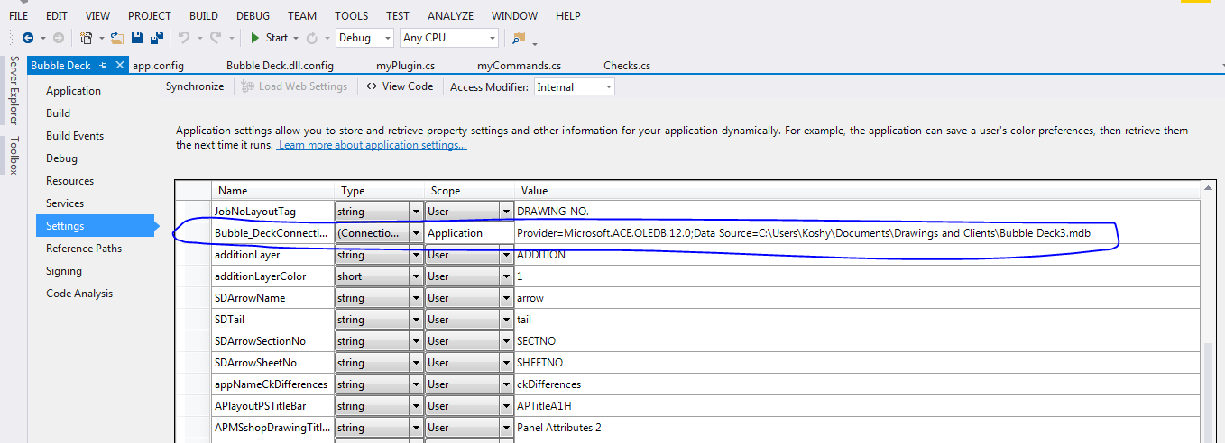

Hi folks
I have created an autocad .net dll. it compiles and runs fine on my computer. I am also connecting to a database. So I am using Visual Studio to store a connection string to that databse. This connection string basically tells whoever's asking, where my Database is. I have stored this connection string using Visual Studio. Basically, in Visual Studio: you click on: Project --> Project_name Properties ---> And you have all the application/user settings. I've just added a connection string there.
(Please see attached screen capture):
Here is how I create the connection in my code:
 OleDbConnection connection = new OleDbConnection(Bubble_Deck.Properties.Settings.Default.Bubble_DeckConnectionString);
In other words it doesn't look like (???) i'm hard coding this because the connection string looks at what the XML file contains.
And the value of the connection string is:  Provider=Microsoft.ACE.OLEDB.12.0;Data Source=C:\Users\Koshy\Documents\Drawings and Clients\Bubble Deck3.mdb
What is the problem?
Works fine on my computer. But what if want to deploy it to another computer?
What I'm doing now when deploying?
I simply go to the Release folder in Visual Studio. I cut and paste the dll in that folder and I give it to my colleague. He then runs it but there's an error:
           "Could not find the file 'C:\Users\Koshy\Documents\Drawings and Clients\Bubble Deck.mdb" at ......etc etc etc
Now on my colleague's computer, I want to change the connection string so that it points to the database on his particular machine. Because it is obviously still pointing to the path specified in my computer. How do I do that?
Obviously it's coded somewhere in my DLL because it's doing that without even me giving my colleague a config file.
In short, how do I change the connectionString to point to the new database location on his computer?

Message 2 of 15
Norman_Yuan
When you add settings via Project->Properties->Settings, VisualStudio generates "app.config" as source file. However, depending on your project type (DLL or EXE), the build-output file of this app.config is different: for EXE app, it is xxx.exe.config, for DLL, it is xxx.dll.config. Just as you need to deploy the xxx.exe.config with your EXE application, you need to deploy xxx.dll.config along with your DLL.
Actually, when wirking with AutoCAD .NET API, you have 2 choices of sacing your settings in config file:
1. AutoCAD has its own EXE config file (acad.exe.config). You can add settings into that file, and use System.Configuration namespace classes to access the settings.
2. Use Propect->Properties->Settings of your DLL project, just as you did. You need to make sure the xxxx.dll.config file goes with your DLL when deploying.
Norman Yuan
Drive CAD With Code

Message 5 of 15
BKSpurgeon
Hello Thank you all for your advice. It will be invaluable to future readers.
I've simply given my colleague my dll and the associated config file (which as you pointed out, was named after my dll). (No installers)
When I netload the dll on his computer, it seems as if the dll is not even referring to what is contained in the config file. I seem to be missing something here.
The connection string contains the location of my database. So obviously on my colleagues computer, I would have to point the connection string to where the database resides on his computer (as opposed to mine). But no matter what I do to his config file (which stores the connection string) -  when i netload Autocad is still looking for the database location on my computer as opposed to his. I have even deleted his config file altogether, but still the connection string source points to the database path on my computer. In other words, the XML file seems completely superfluous.
This is how I"m referring to the XML file to pick up the connection string from the XML file:
In other words how should I refer to the config file from my DLL so my dll will pick up all the settings stored in the xml file?
I don't know how to fix this. Any advice would be much appreciated.

Norman_Yuan
Hi Keith,
I have to disagree with you. There is nothing wrong using .NET built-in application setting mechanism (*.config), be the project is DLL or EXE. In early version of .NET (1.x for sure), there is only app.config can only be outputed as *.exe.config. Output app.config as *.dll.config was only available in later version (since .NET2.x or 3.x, I could not remember exactly).
I remebered when I started Acad .NET API programming with .NET 1.1, I had to place some of app settings in acad.exe.config, which caused technical diificulty when the app settings needed update, because acad.exe.config usually is located in C:\Program files\... folder, along with acad.exe, and that folder most likely a read-only to non-local admin users. with *.dll.config, as long as it goes with the DLL, all the settings in it can be accessed just as in *.exe.config. Now, with *.dll.config, in some CAD applications, I no longer need to update acad.exe.config, if some settings are needed. I can place them in the DLL's Properties->Settings, which eventually go to *.dll.config. But to be honest, I rarely use *.config file for Cad apps I developed, because we are in a corporate environment, we have a centralized app setting system for all application level settings. Only when very few user level settings are stored in *.dll.config files.
Also, with app.config, the settings can be in 2 scopes: application and user. for application level of settings, they are read-only once they set in the config file. However, for user level of settings, the values in the config file are default value, after the first time run of the DLL, a copy of the config (be it *.exe.config, or *.dll.config) would be created in user's profile folder (C:\Users\[user name]]\app data\local....the value of the settings in user copy of the config file can be updated.
To the OP's case, if not taking security (exposing database connection information) into account, there is nothing wrong to store the connectionstring as application setting in the config file. While in my reply I used application level setting, the OP may want to use user level setting with default database connection. Then he/she can use code to handle DB file not found exception to allow user to choose a different database file in user computer, and then save the new connectionstring to the user level setting, so that the setting would be used when that user logs in this computer and runs the app.
The only thing that puzzles me is why the simply mechanism of *.exe/dll.config not working for the OP

Message 14 of 15
Norman_Yuan
Sorry to come back to this topc very late.
I was only partially correct on what I said previously about *.dll.config, and wasn't explain clearly (or correctly) what would happen when you done with your coding and try to use the dll with its *.dll.config in different computer with different setting values.
I happened run into an article that has a quite complete explanation on how to use configuration settings with .NET DLLs, which would definitely be very helpful:
http://www.sep.com/sep-blog/2010/09/05/configuration-settings-for-net-class-libraries-dlls/
