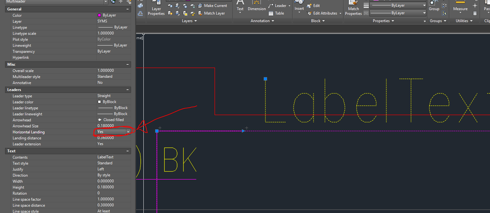

Hello All,
I am creating Mleader via C# .net, it work find. but as per project need I want to set "horizontal landing" as "No". Capture.PNG

Jeff_M
Use the EnableLanding property?
