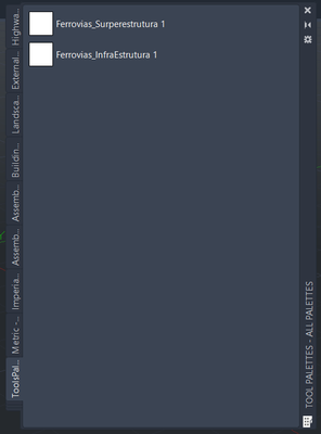

How to add a title and separator in the Tool Palette Manager using C#
artillis_prado
My code can create a palette and add the PKT files via path.
I am using the Tool Palette Manager from the AcTcMgd DLL.
However, I'm unable to add text or a separator via C# code. Does anyone know how to do it?

What release of AutoCAD are you using that forces you to resort to sending lisp Expressions to the command line?
Message 3 of 11
ActivistInvestor
That was a question but it definitely didn't solve your problem. There should be a property named ToolType that can be assigned the value ToolType.Seperator or ToolType.Text.

About your original problem, to create a separator or text, you have to create an Autodesk.AutoCAD.Windows.ToolPalette.Tool, and set its ToolType property to ToolTip.Seperator or ToolType.Text.
Message 6 of 11
artillis_prado
How do I add it to the palette? My question is how to add it.
Message 7 of 11
ActivistInvestor
First, You should have mentioned that the code you posted is from a 2009 Through The Interface blog post.
You add items using the AddChild() method.
Message 8 of 11
artillis_prado4J852
I realized that it accepts catalog as a parameter, and not other parameters I am experienced with the autocad api, so these doubts
Message 9 of 11
artillis_prado4J852
Message 10 of 11
ActivistInvestor
CreateTool() and CreateCommandTool() both create and return a Tool object, and adds it to a Palette.
Message 11 of 11
artillis_prado
But, so you know an example of what it would be like using Tooltype, to add text or separator
I think these commands are not useful for ToolType, because both commands you mentioned ask for an image
