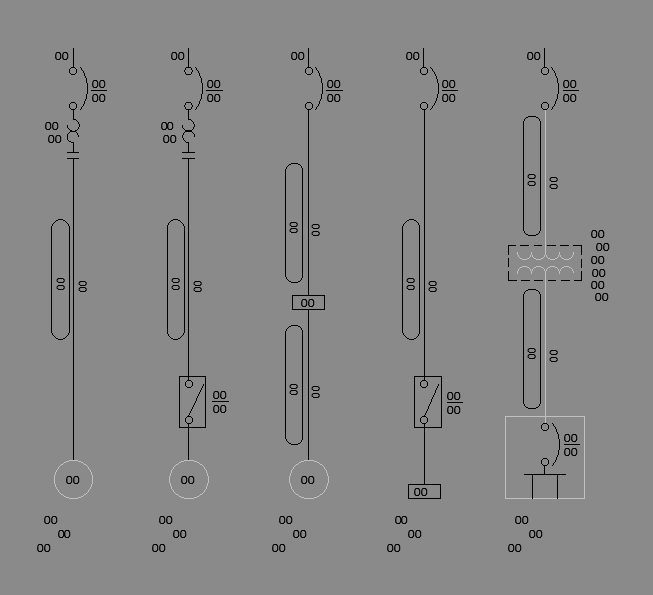

Hi, I have a project I am working on with blocks and attributes. I am trying to drop a block and have a code that can fill in the attributes of the block from an Excel Data sheet. Is there a way I can code this? I know I can use ATTOUT and ATTIN, but I need to create a code using C# and .NET. Thank you.
299 Views
irahmanJS6UB
Here is an image of my blocks.
