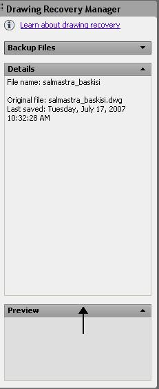

Hi, anyone know what is that we call in the palette set? is it possible i create one? and if so, how can i create 1 in the palette set created? thanks a lot.

Deending on which UI technology you use:
If you use Win Form , there is no .NET built-in control for that, but there a few third party controls, or you can make your own (you probably need to write quitw some GDI+ code
If you use WPF, its controls are extremely flexible for customizing its look.  It is "Expander" control for this visual effect. Googling "Expander control in WPF" would bring up tons of links to various examples and tutorials. Well, you'd better to use Acad2010 or later in order to host WPF user control in PaletteSet.

You bulid one on a usercontrol there a class here and classes about WPF
http://au.autodesk.com/?nd=class_listing&filter_keywords=&chunk=100&filter_type=&filter_track=6&filt...
