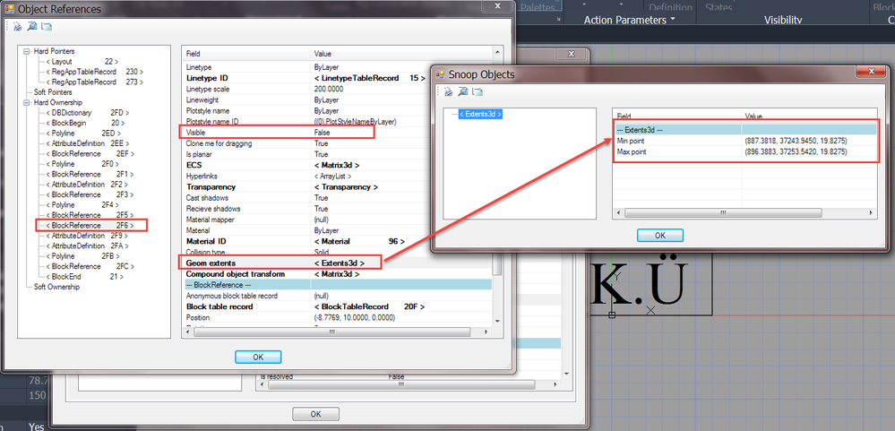

There is a block in the attached drawing. When I try to get the boundary by
        Dim acExts2 As Extents3d
        acExts2 = obj.Bounds.GetValueOrDefault()
the returned boundary is too big as seen by the red rectangle. I tried to bedit and there is nothing else in the block. There is no problem with other blocks just this block.
How can I fix this?

This block has internal blockreference (non visible), which is very far:
