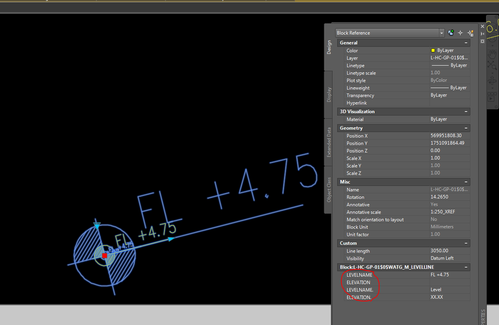

Hi anybody,
I have a question that is how to do get information into blockreference.  Can see attached image below and have a markup red color on properties of it. Help me please.
I'm using C.#
Thanks.

These are called attribute references (AttributeReference).
They are contained in the AttributeCollection of the block reference.
You can use some function like the following to get the attribute values.
Dictionary<string, string> GetAttributeValues(BlockReference br, Transaction tr) =>
    br.AttributeCollection
        .Cast<ObjectId>()
        .Select(id => (AttributeReference)tr.GetObject(id, OpenMode.ForRead))
        .ToDictionary(att => att.Tag, att => att.TextString)

In the image you posted, the values you circled in red don't appear to be block attributes.
Can you tell more about these values, and where they come from?

anhtrung
@_gile Thanks, that is the needed.
