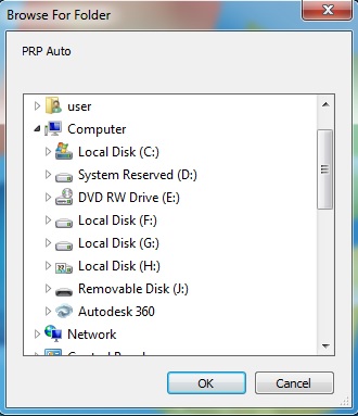

Hi Guys,
i'm writing a small c# program that creates a script file to be run from outside AutoCAD and have this issue:
(the script will be running on series of dwg files)
FolderBrowserDialog class (see the picture) under Microsoft VS 2015 comunity version
i would like to change the Captain text + delete the extra empty line in the Description field and i can not find how?
(can not find the fields to change in the properties pane for the FolderBrowserDialog in VS)
thanks in advance
Moshe

_gile
            var browser = new FolderBrowserDialog();
            browser.ShowNewFolderButton = false;
            browser.ShowDialog();
displays the same as (acet-ui-pickdir)
            browser.Description = "Some description";
displays the same as (acet-ui-pickdir "Some description")

Moshe-A
sorry _glie but this is not exactly right. here the (acet-ui-picdir) format:
(acet-ui-pickdir [message [startDir [caption]]])
Displays a directory selection dialog.
Arguments
message: If provided, a message to be displayed in the space above the directory tree control.
startDir: If provided, the initial directory to be selected.
caption: If provided, the dialog caption.
Return Values
A string containing the name of the selected directory, or nil if the dialog was canceled.
i agree we can change the description but i am looking for captain args
this is how i want  FolderBrowserDialog to be  (picture from acet-ui-pickdir )
(note that decripton field has only 1 line where FolderBrowserDialog displays 2 lines)
thanks
Moshe
Message 10 of 13
_gile
As far as I know, there's no way to change the caption/title of the System.Windows.Forms.FolderBrowserDialog.

zputman
I use the CommonOpenFileDialog from the Windows 7 API Code Pack on NuGet.  It was published by Microsoft and I have had no problems with it.  The dialog looks like the picture below.  I hated not having the address bar or favorites of the other options.
