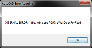

Hi guys, I've a problem.  I need to print each layout of my drawing using PlotToFile method of the ActiveDocument.Plot obect, but randomly AutoCAD crash (internal error message popup) with eWasOpenForRead code.  This is my code:

In the mean time I try also by changing
acDoc.SetLayoutToPlots() with acDoc.ActiveLayout = layout (variable layout is the item processed by the foreach statement) but I get always the error.
As attachments there's the error...
Enrico
