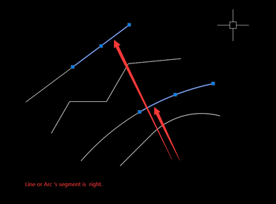

I need split Curve3d into segments,
and then Create database Curve,
when I select a Line or a Arc,
the result is right,
But when I select a ployline,
the result is wrong,
the "sub polyline" is as long as the source polyline。
Who can help test the above code,
Find out where my error is。
Thank you so much!

Thank you for your reply。
The test code is a simplified version,
I need to use the method “Curve3d.GetTrimmedOffset Method (double, Vector3d, OffsetCurveExtensionType)”,
And it needs to be calculated with other elements(BoundedPlane),
So I convert the DatabaseServices.Curve into Geometry.Curve3d.
I know the method “ Curve.GetSplitCurves (Point3dCollection) ”。
When my code runs incorrectly,
I thought it was my fault,
So I wrote the test code to ask for advice。
My current workaround is to use the method “ Curve.GetSplitCurves (Point3dCollection)”。
Thanks!

I found a workaround:
Create a new CompositeCurve3d use the Splitted segment,
var newSegment=new CompositeCurve3d(new Curve3d[] { tmp });
the new CompositeCurve3d is the one I needed!
