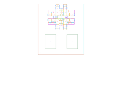

I am using the AutoCAD Plot API to export a user-selected window area from model space to a PNG file. However, I'm encountering the following issue:
1. When I select a window area (as shown in Image1), I want that exact same area to be exported as a PNG.
But the output shows a different area (as seen in Output_Image).
I have tried several approaches to adjust the scale, such as using StdScaleType.ScaleToFit and SetCustomPrintScale, but none of them have worked for me.
Can anyone help me resolve this issue?
Attached Below code for your Reference

"I am unable to map the plot page and model space coordinates using the code below.
I would really appreciate it if anyone could test it."
