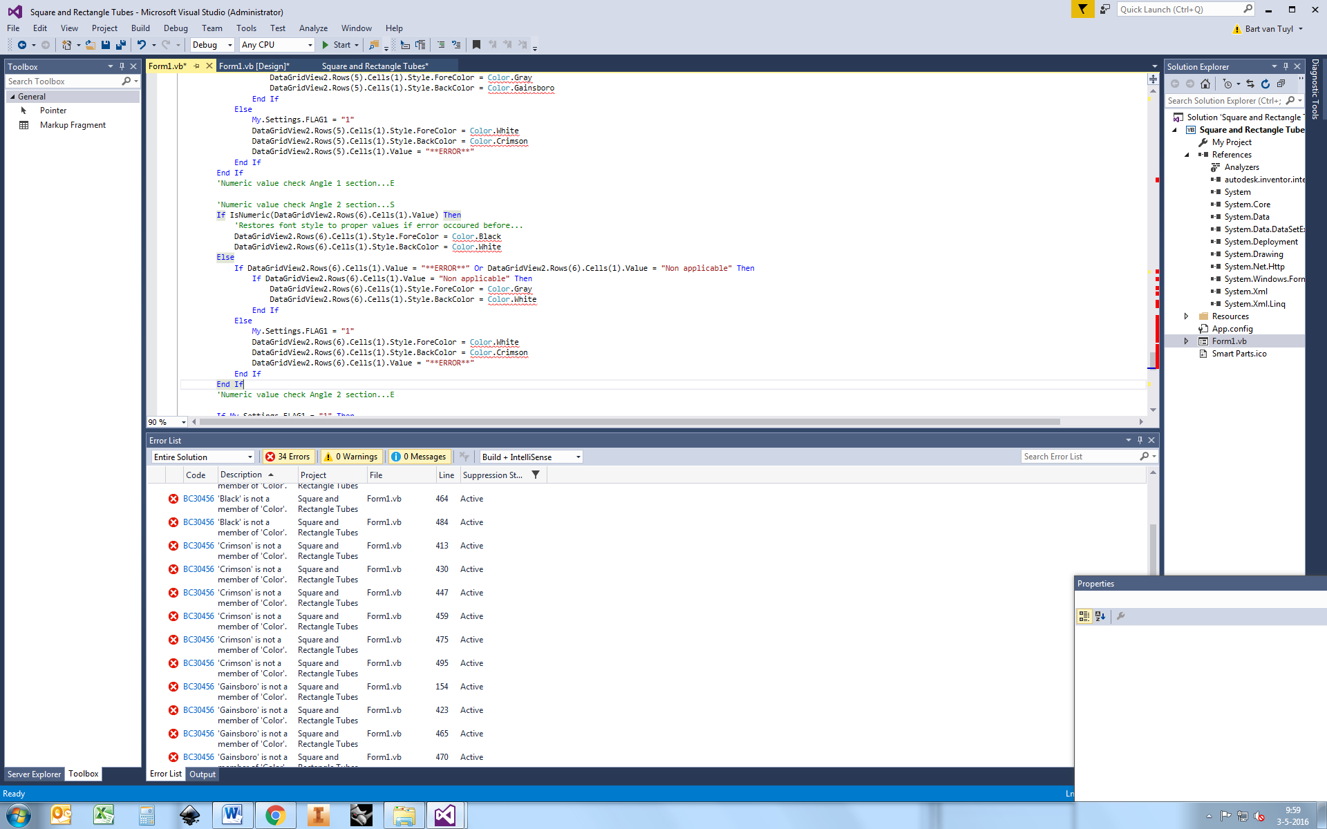

Hi I have a form that I created in vb.net which had no errors untill I refrenced the Inventor "Autodesk.Inventor.Interop.dll" now anything to do with color such as the code bellow has an error stating that "Black is not a member of color"? Thats really anoying dose anybody know how to fix this?
  'Numeric value check Angle 2 section...S
        If IsNumeric(DataGridView2.Rows(6).Cells(1).Value) Then
            'Restores font style to proper values if error occoured before...
            DataGridView2.Rows(6).Cells(1).Style.ForeColor = Color.Black
            DataGridView2.Rows(6).Cells(1).Style.BackColor = Color.White

I don't know the Inventor COM API but it may contain a 'Color' type which should create a conflict with the System.Drawing.Color one.
Try using the fully qualified name:
DataGridView2.Rows(6).Cells(1).Style.ForeColor = System.Drawing.Color.Black
DataGridView2.Rows(6).Cells(1).Style.BackColor = System.Drawing.Color.White

Fair enougth this works... Why is this happening then? (just trying to gain understanding)
Message 7 of 8
_gile
As I said, two different namespaces may contain a type (class) with the same name so, you need to differentiate them using their fully qualified names (or aliases if this exists with VB).
