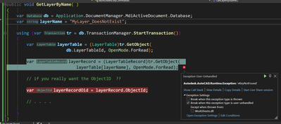

kerry_w_brown
Of course, we should check that the LayerTable actually does have a Layer of that name  🙂
. . . or this will happen :
public void GetLayerByName( )
    var db = Application.DocumentManager.MdiActiveDocument.Database;
    var layerName = "MyLayer_DoesNotExist";
    using ( var tr = db.TransactionManager.StartTransaction( ) )
        var layerTable = (LayerTable)tr.GetObject(
                db.LayerTableId, OpenMode.ForRead);
        // ensure the layer exists !!
        if ( !layerTable.Has( layerName ) )
            // show a message to the user.
            // then :
            return;
        var layerRecord = (LayerTableRecord)tr.GetObject(
                    layerTable[layerName], OpenMode.ForRead);
        // if you really want the ObjectID  ??
        var layerRecordOid = layerRecord.ObjectId;
