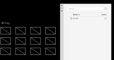

in the attached DWG, I have an initial block, the same block in an array, and the same block in an array that used the array classic.  If I then do a BCOUNT, the BCOUNT will report 17 blocks.  these are the single block that I used as the base and then the 16 blocks created using the ARRAYCLASSIC.  It does not count the blocks in the ARRAY.  The only way to get a count of these blocks is to explode the array.  Does anyone know of a C# way to report out a block count in the DWG that also include blocks inside ARRAY's?

ActivistInvestor
The files in this repository folder should do what you need. They are distilled versions of other more complex classes from the same library (that have too many dependencies to use without dragging in a lot of other code).
The code includes an example (the 'DEEPBCOUNT' command) that should report the number of insertions the user actually sees.
In the clip below, I added 3 nested block references to the block that is arrayed. One of the two blocks is inserted twice.
