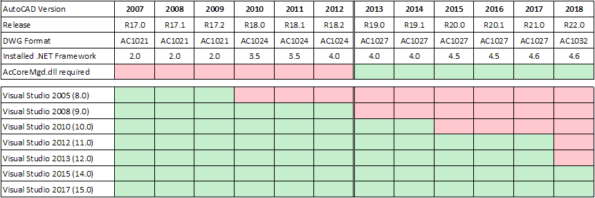

Oscar_ITzone
Where can I find an update of this table correlating AutoCAD versions and .Net framework to target?
Thanks!
Oscar
Message 8 of 9
_gile
You can also see this page from the documentation.
