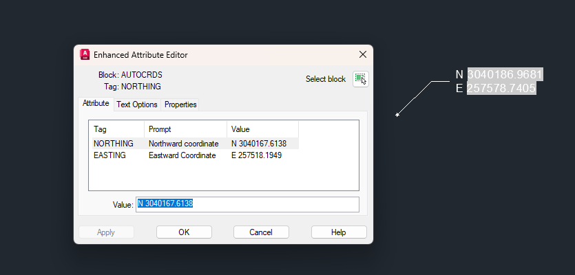

ed.Command("-Insert", "AUTOCRDS", coordMarkPosition, 1, 1, 0);
I wat to insert a block in my drawing with name "AUTOCRDS" at position coordMarkPosition which is Point2d, now i have used ed.Command method to insert a block at coordMarkingPosition with x and y scale values 1 and rotation angle 0, now the block has two attributes "NORTHING" and "EASTING" which takes values of x and y coordinates of coordMarkPosition as shown in image, after running this code, i want to manually click ok after that the block get inserted, how to automate it? AttrEdit2.png

Assuming that you want to supply the attribute values programmatically, Set the ATTDIA sysvar to 0 and supply the attribute values as arguments to Command().
mayur_kapadnis
It works, thank you
