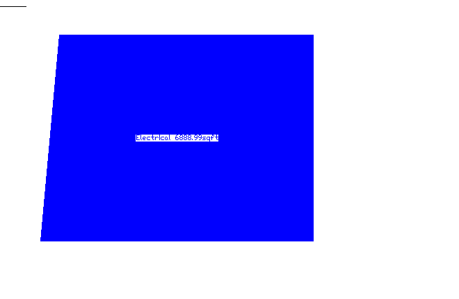

I have handle for polyline and mtext. it looks like this.
I would like to make it looks like this
What should I do?
Thanks again

Thanks so much. Modelspace is the key problem. I have modified my code and got the result I need.
