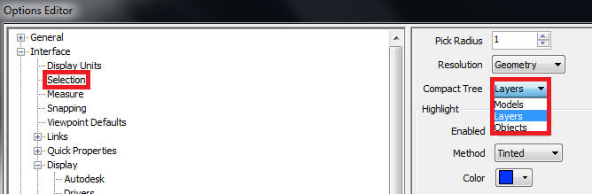

You can change the selection tree viewing properties in Options Editor, Options Editor can be open by selecting F12 key
