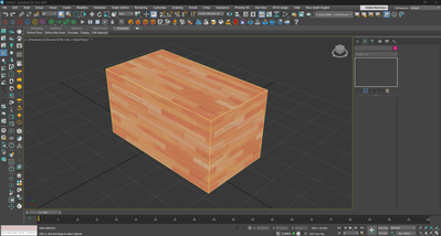

Hello @darrenr, I hope you are feeling very well. The way I have solved this is as follows. I start from a very simple model created in 3ds Max, a simple box (it's just for example):
I have exported it taking care to export everything you say you have:
